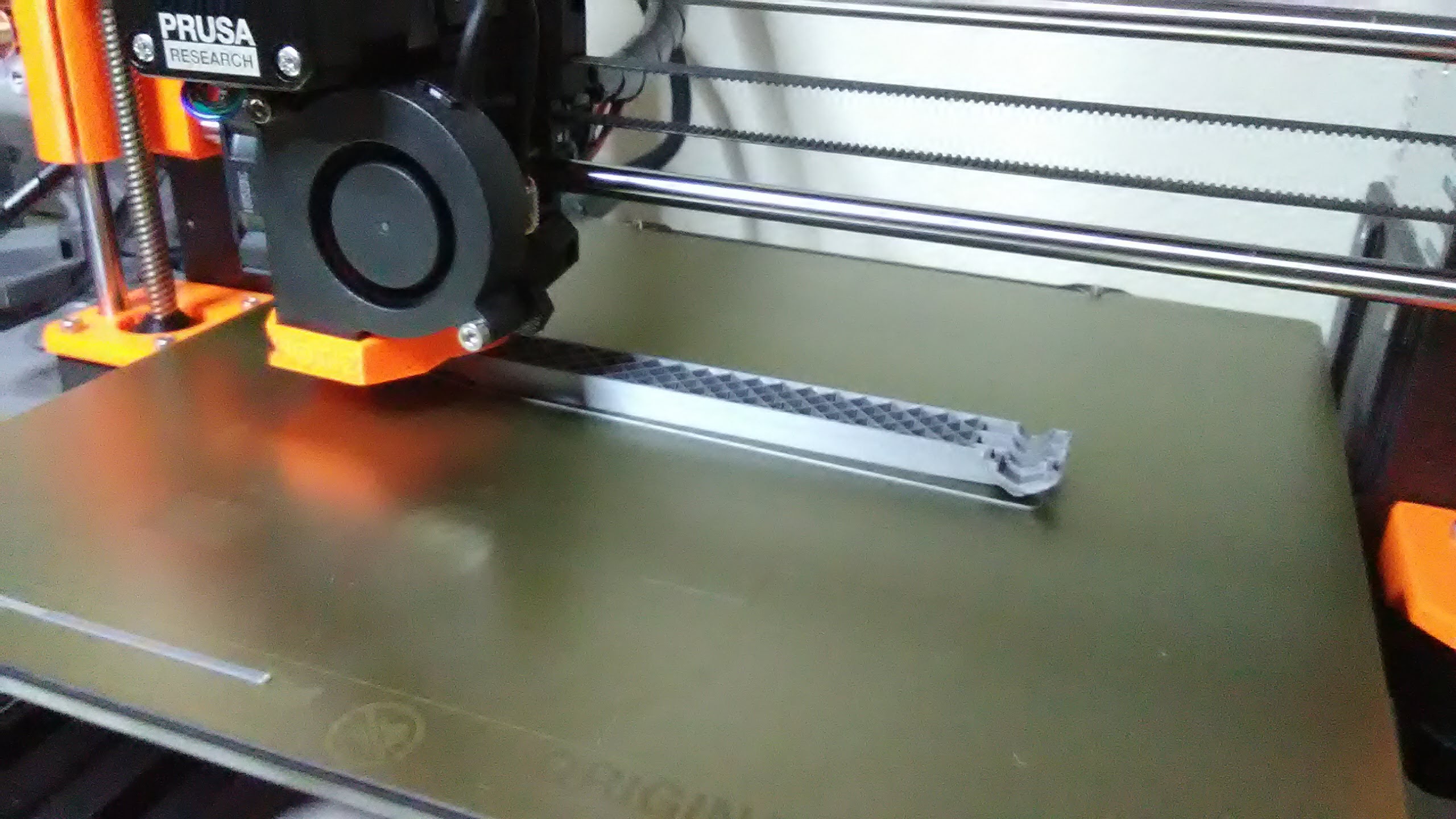

Turns out the calibration you use via the control panel is not the way to go. Once I figured this out all was great in 3D printing land. If you purchase one of these do yourself a favor and print one single layer on the print bed and adjust using this model then theirs. I made mine 4 inch by 4 inch and was better able to see the quality of the print and the adhesion to the bed. Dialed it in and now I can walk away from printing and come back to a fully printing item.
Jeff Gros it was the first layer of a box measuring 4 inches by 5 inches. This allowed me to better see how the filament was being laid down. I would run it and if I didn't like what I was seeing adjust the Z axis. This took me the better part of the morning but now everything sticks.

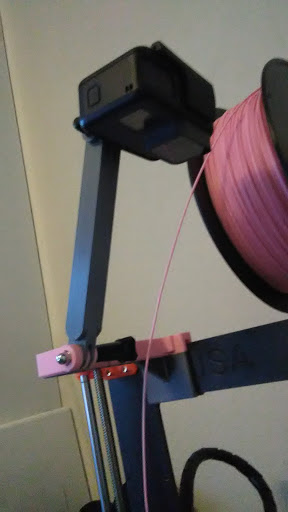

Just finished this arm for my camera. And ultimate test ran out of gray filament and swapped out for pink. It was all I had. Wonder what a coat of spray paint would to the PLA. Time for a test.
