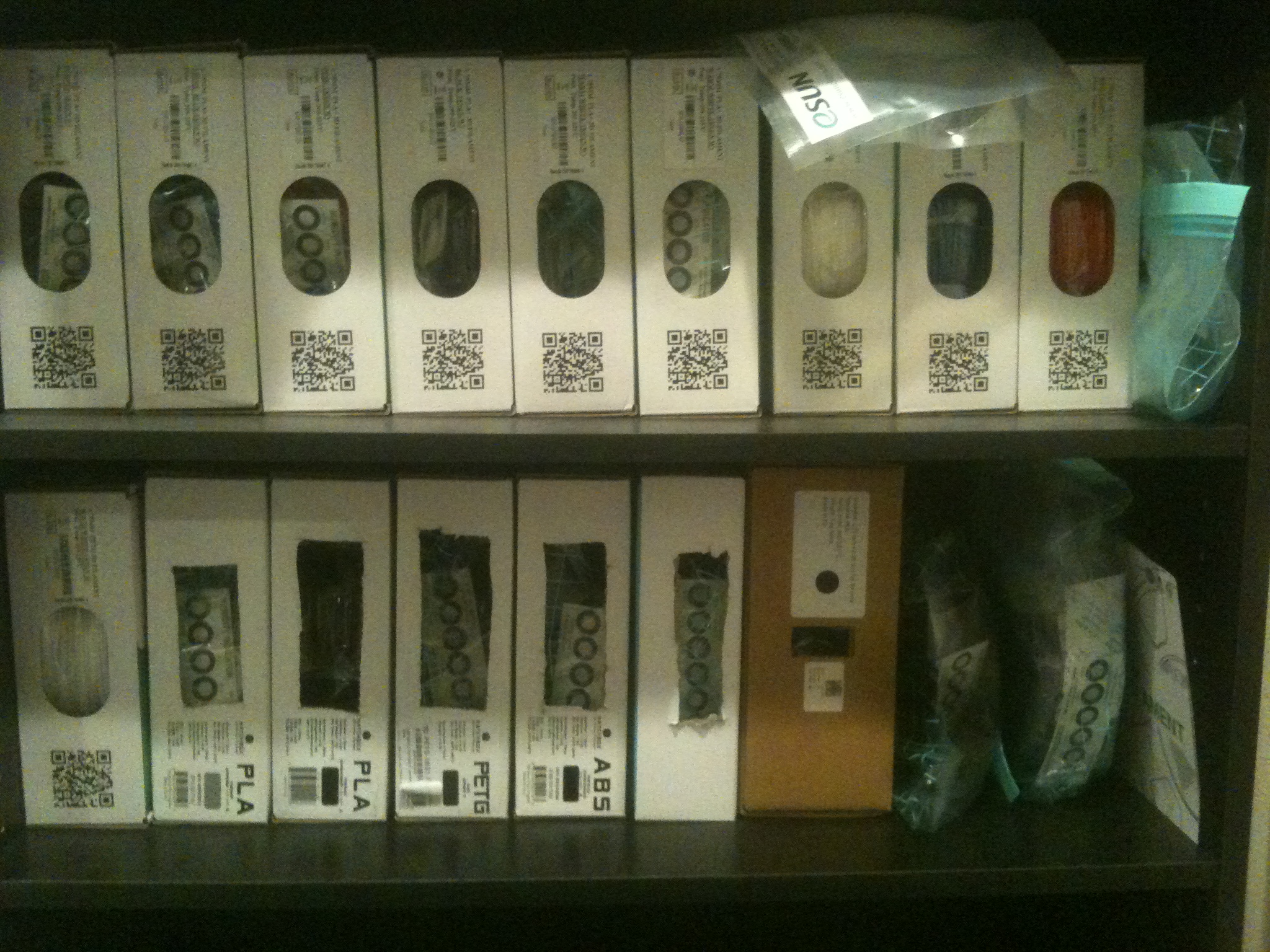

This works really well in my filament storage setup to keep the filament safe from moisture. I keep the spool in a ziplock bag, with a moisture detecting tag and some dessicant baggies. This ziplock bag, with spool, is kept in the box, which slides onto my shelf. I can see the moisture tag through the window for eSun. You can see in the picture that I had to carve a hole in the box for hatchbox and polymaker.
Jeff Gros thank you. I was wondering about keeping the filament in some sort of storage similar to the vacuum packed method when purchased. Now to order some ziplock bags. Where do you get the detecting tag and desiccant bags?

The bag is the tricky part, as most ziplock bags I've tried are JUST a bit too small. The 4.5L bags are a nice fit for most spools, and you can use the 6L for the jumbo spools.
You might have seen vacuum pump bags (like for storing clothes that you don't wear much). I tried those, but they leak! Don't bother....
For PLA keeping dry is probably not that much of an issue unless you live somewhere super humid. PETG is a bit more hydroscopic. But Nylon needs to be printed from a drybox!
If the filament does get wet, what will happen is that it will get brittle (you can snap it with your fingers), and it will release the water as it prints (it will spit water vapor) which can make for bad prints.
You can also "recharge" your spool by sucking the water back out. Either by throwing it in the oven, or putting it in a food dehydrator. Same for desiccant packs. Although they're so cheap, why bother.

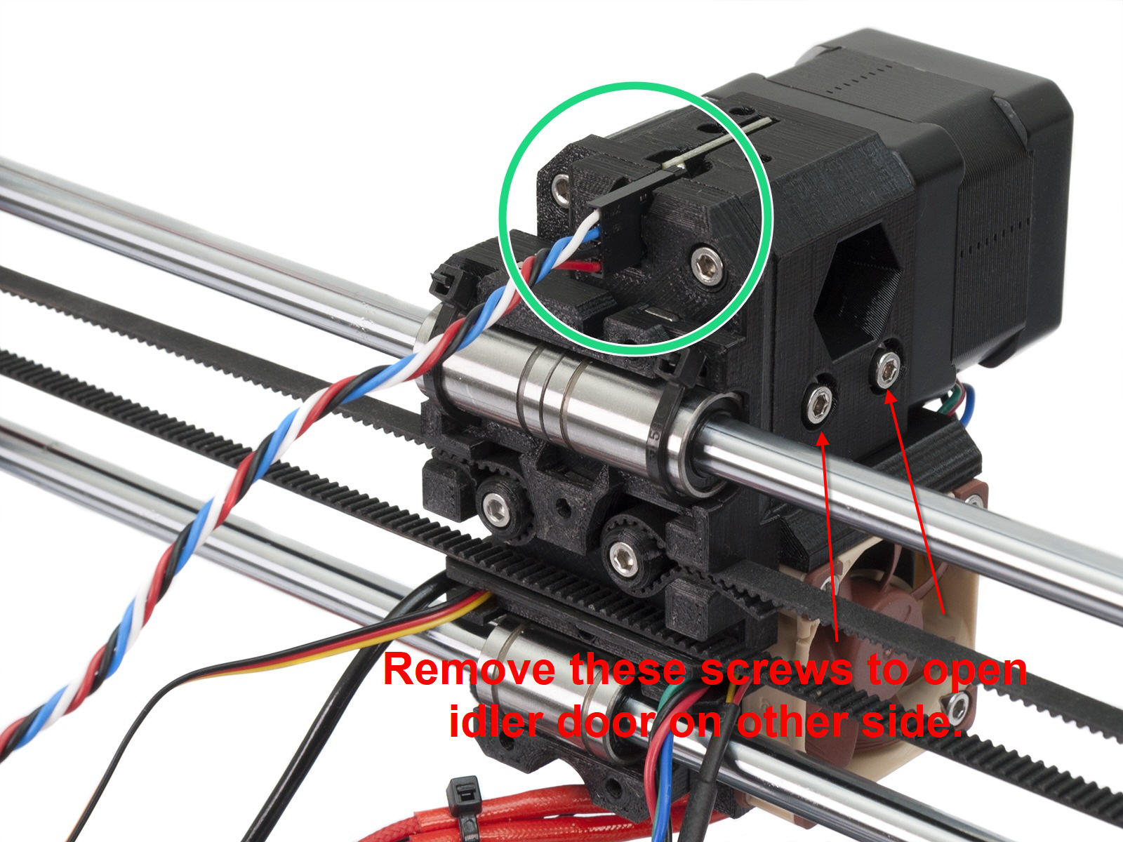

After getting the kinks out of my printer, standard stuff, the filament broke and left me with unfinished print. The filament is the one shipped with the printer.
Cleared the clog in the extruder by raising the temperature 250 or so and loading and unloading the filament. With a bit of help was able to get the filament to push out. BTW before this occurred could hear this clicking sound but could not tell where it was coming from turns out it was the pully feeding the filament; skipping.
Once cleared loaded filament and all was fine then the clicking sound started again. Checked to make sure the filament was not tangled or misaligned possibly causing undue strain on the pully. The clicking wasn't terrible so I unreeled some filament taking any and all strain off the pully and eventually the clicking went away. Three hours into the print the print head stopped extruding filament.
Tried to unload filament but failed it is not coming out and it won't feed so now I have to open up the extruder and see whats wrong.
Will need to go back and see if I can find how to open the extruder pully area. Seem to remember the pully area having a hinged access area.
Will bookmark your suggested links and get back to them when I get this ironed out.

You also mentioned how to open the extruder pulley door? What you are looking for is the extruder idler door. When looking at the prusa logo on the frame, on the left hand side of the extruder assembly there are two large screws that tighten springs. The springs allow the idler wheel to move and flex as filament passes through. The idler wheel keeps tension on the filment so that the extruder gear's teeth can grab the filament. Unscrew these two screws and the door will swing open, giving you full access to the filament inlet to the hotend. I've made a picture showing the screws. Ignore the green circle. I couldn't find an image in the build instructions without some sort of marking on it.

Jeff Gros great info placed the links in my browser manager and will review them soon. I like the idea of preventive maintenance using the cleaner filament this "is" a common problem. Lastly, thanks for the instructions on opening the pully access door, did it and cleaned out the pully area. There was a bulb on the end of the filament stopping it from pulling back or more correctly unloading filament.
