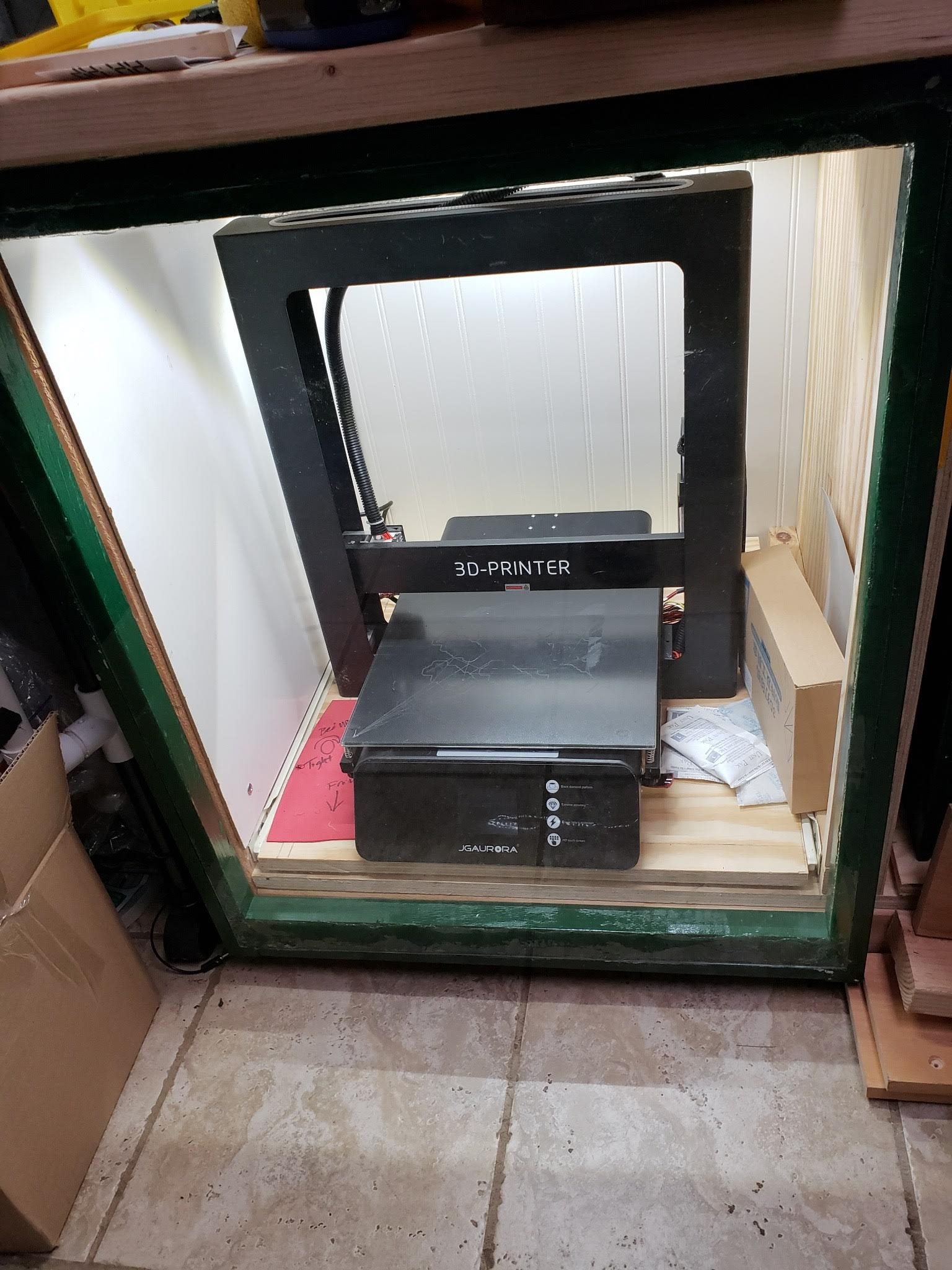

Congratulations on your first 3d printer! I recently purchased my 3rd, a JGaurora a5. Been using fusion 360 for around 3 years (couldn't stand tinker cad, the little sibling to fusion). It has a little bit of a learning curve but there are a ton of great videos for help. The ones mentioned are great and Lars is very active and responds to emails.
Not sure that going with polycarbonate over plexiglass will make much difference if your printer catches fire. Plexiglass is laser cuttable where polycarbonate isn't as it emits poisonous gasses. I built my enclosure into the base of my bench. 18664%20-%20gplus25dc083885327bb1523c028

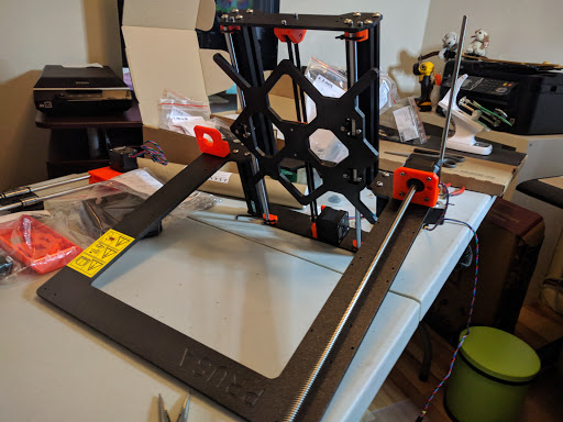

Well between wife's do list and backyard projects managed to get some time to start the 3D prusa build.
As those wondering how the build is going a few missing screws but that was alleviated by the bag of spare parts they send with the kit.
So far there are a couple things I found vague.
First one is how tight the bed plate belt so be there is nothing other then make sure it glides freely.
The second thing I spent a lot of time on was the portion of the build where they mention how to level or remove rocking motion from the frame, early stages of the build. The instructions a once again vague.
Trying to get some more build time in today. Reminds me of building RC cars or model airplanes.
Here is the meager progress.

Looking good! If you can point me to specific questions in the online build instructions I can do my best to answer them.
The MK3 is much easier to build than the MK2. The MK2 had threaded rods for the Y axis frame held in place with washers and nuts. I remember spending a lot of time rechecking the Y axis frame and ensuring it was level in order to get the lauded "axis perpendicular" message when running the calibration.

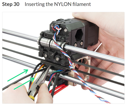

There is one step seemingly impossible to complete. They call out a short filament to be inserted to the printer head simple enough only all the force in the world will not make this filament go into the hole described. There is no explanation what this filament does?
Yes. I remember this part. Very difficult.
What does it do? Its just a cable stiffener.
In the end i ended up shaving some of the filament so that it was thinner and easier to insert.
In my MK2 it actually popped loose during printing. I printed with it loose and it caused no issues, as there were other pieces holding the cable to the extruder. Its just a cable stiffener after all.
Still inserted on my MK3! :)
